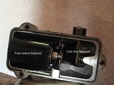

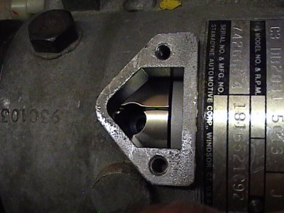

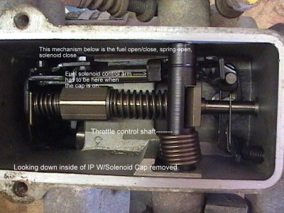

Pull the IP solenoid cover off, it should be full of diesel. Hook up your 12V to the solenoid, make sure it is working. You can pull back the shut off slide by hand, spring should close it when you let go. About the only way to see if the input (IP drive shaft) is broke, take the front cover off the gear tower, turn the engine over by hand until the drive dowel is at 12 O'clock, clean and remove the cover on the side of the IP, stick a 5/32" hex key in, like adjusting the fuel, then see if you can move it up and down, should be NO movement, if so the shaft is broke. The last pic shows the drive shaft broken, this was the results of turning up the fuel and the screw head broke off. Not mine.
Just make sure when you put the solenoid cap back on, it's in the right position, see pic.

There was a small needle pin that pushed against a spring like device in the fuel return fitting that screwed into the top of the solenoid housing. If the solenoid isn't working then the pin isn't moving and the return line won't allow fuel flow. This was not the case. I checked the solenoids again once I'd removed that fitting and the pin does move, whether it moves enough is another question but the pin does seem to be operating at least in some capacity. As I removed the injector lines from the injectors, not a single drop of fuel was in the lines. IE no leaking or dripping fuel. Once I'd removed the pump I was able to easily rotate the shaft and no fuel spilled out of the injection lines, although there was definitely fuel in the body of the pump as it was visible through the fitting port I'd removed from the return fuel line.

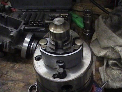

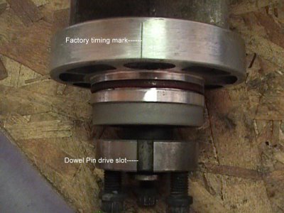

OK so I finally had time to get the pump stood upright and take a few things apart. The screen was clean, but the impeller looking device under it doesn't rotate when you turn the main shaft, the one that attaches to the IP gear. I could rotate it independently and watch the four spring loaded paddles move, but it doesn't seem to work when you rotate the main shaft. So I'm inclined to say the shaft is broken, but I'm not very familiar with this IP so maybe someone can tell me what it does if its working correctly ?

X2 on what Black Dog said. If the transfer pump vanes aren't moving when you rotate the shaft, then the shaft is broken...time for a pump
