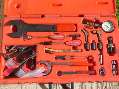

Here you go. This is the cheapest tool for the nuts I have found on ebay.
http://www.ebay.com/itm/251548874984?_trksid=p2055119.m1438.l2649&ssPageName=STRK:MEBIDX:IT
That one looks pretty much like this one in the specialized set I was lucky enough to borrow when I changed out my IP. The socket in question is the lower right in the picture.
attachment.php
