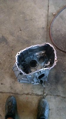

Well. Tomorrow I'm going to open up the zf with the cracked bell housing. I know the one in the 4x4 needs 2nd, 3rd and reverse at least. So doing the spare makes sense to speed up the clutch job . First time doing one of these.
Can't be near as aggravating as the getrag I did a couple years ago.

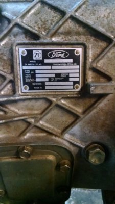

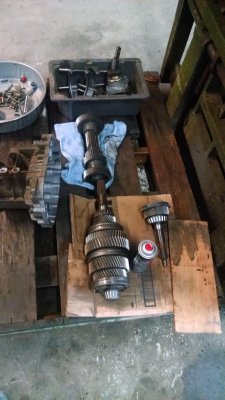

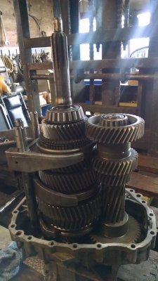

I had forgotten about that write up. . Anyway got the trans apart, no gears off yet but other than synchros touching cones on 3rd gear it looks great inside, A tiny bit of water damage but for a 50 dollar core im happy, now to get the full bearing kit coming. The bearings arent shiny, kinda dusty looking . Its getting a full set regardless.
Heres some basic pics.
Ive done hundreds of transmissions, this is the first ZF
