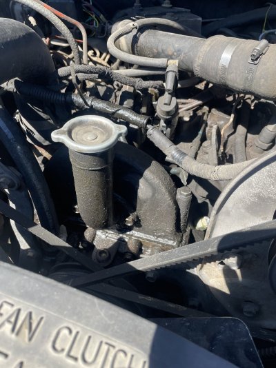

Hey there I have looked for the plugged port but it looks like mine lacks it entirely? I can attach a photo and maybe I’m just missing it? There is a connector with a wire going into the bottom that feeds into the cab but I figured that’s for the aftermarket oil pressure or water temp gauge.

Alright I think I may have figured out what the issue may be. For some reason I believe the previous owner had to swap out the IP and or the cover. When they replaced it they must have just used an older model cover that doesn’t have the sensor port and since it’s a c6 and doesn’t rely on that just let it be and let the stock wires dangle. Maybe it was when they were adding the aftermarket turbo? I’m going to try to track down the stock wiring connector and if that’s the case and it gets power than I may just buy a new/used IP cover that has the sensor port. Will update when I get it figured out.
Yep. One or both years 83/84 lacked the port. My 85 RV has the plugged port, so it had to have been older than that. Another obvious thing is the oil filler. That's the old cam-on filler cap. Not sure when they switched to the plastic threaded cap with an angled filler neck, but my 87 has it:

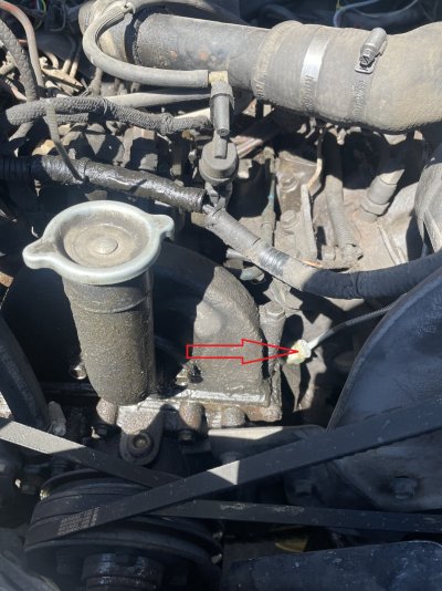

Isn't this his tach. sender? And he could test, or just replace, that to start with?
Sorry if I'm not following along correctly.
No, that's going into the water jacket. The factory water gauge probe goes there, at least on both of my 6.9 engines.
Here's a fresh pic I just took of my RV to point this out.
I put my aftermarket gauge sending unit there because it was easier to reach than the dummy light port in the Econoline engine bay. You can see the factory wire hanging there next to it. On my F250, I put the water sending unit in the dummy light port, a bit further back towards the firewall.
That huge pipe plug there in the foreground is where the tach sensor would go.
A web pic showing a tach sensor installed on a later housing with the angled filler and plastic threaded cap.
