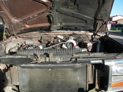

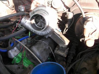

I found a t70 (master power) locally for cheap, so I bought. It was too big to put it right on the manifold (I have the rajay/roto master style turbo system), but the angle on the turbine was different so it was hitting the power booster and clutch master, so I build an adapter (just tacked together for fitment for now).
I already know the quality of the turbo so no need for cheap/ebay/china turbo "you're gonna grenade your engine" remarks.
It is a little more laggy than the t04b 60-1 that I had before, but I made 15psi in first gear (zf5 close ratio), whereas I only made 12 with the t04. The propane injection definitely helps light up the turbo though. It has a .68 a/r t4 non-divided turbine, with a p-trim turbine wheel, the compressor is also a p-trim, with a 70 a/r housing.
Thought someone might be interested. Thanks for looking.

I love the felpro premium gaskets, mine have never leaked. I just changed them when I did my head gaskets/studs. Getting the turbo off is a pain if it has been sitting for a while. It definitely adds time when you break stuff too. I broke four bolts when I had to take the last one out, and the oil drain tube. It's still easier to work with than the ats 088 kit.LOL

It isn't too bad compared to the last one( it had a .96 a/r t4), but it's probably a lot worse than everybody else with the t3 turbine h trim turbos. It wouldn't be the best for towing but it's good for what I do now, and the propane definitely lights it up. I'm seriously thinking about getting a smaller high pressure turbo to push it into.:sly

I got it all done except I'm waiting on some exhaust bends to make the down pipe. The lag is worse than I remember, so something will have to be done about that, but it keeps building boost until I let out now. The last turbo would just peg at 15. I'll post a video of it as soon as I can get somebody to hold the camera for me.
