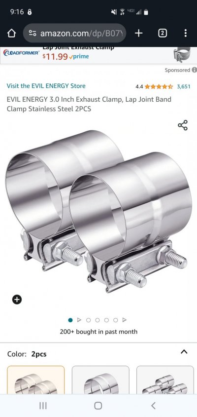

Are these any good? My pipes are leaking at each slip joint. Frustrating.

If it is the metering valve sticking I've had pretty good luck with Hotshots Extreme fuel cleaner. The pump on Tank is starting to show it's age and a dose of that stuff whips it back into shape for a little bit longer when things start sticking. It's not enjoying sitting not getting driven.
chillman88
Feb 22, 2017
6,027
6,155
Central NY
Which is the better brand? I just happened to find these on Amazon.
I just bought whatever Napa had last time. I wasn't knocking that brand just never heard of them. I think Walker is all I've ever used but that doesn't mean they're great, just the only ones I've tried.
I needed 4 inch and they were $14 on Amazon or $18 at Napa made in USA stamped on the box so I was happy not needing to wait for them to show up.
