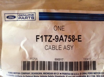

ive been having problems with my throttle cable getting stuck, and of course as you all know it is the plastic housing around the cable that has gotten brittle and broken off causing the throttle to catch, so I thought about napa , oreillys , and advance , but there was to much negative feed back on here about aftermarket cables , so I called my friend at the local ford dealer and ask if he could get it , he found a part number and ordered it. so I thought I would share the part number,
it works great, but kinda hard to install if you have a turbo

Yeah mine broke so I bought one from Napa and it was 6 inches longer than my old one..... Everything fit, had a little extra slack but my pedal was hard as !@#$ to push down.... I dunno what to do about it :p It has to do with the length and all that extra slack. I am gonna compare it to Fords, might just be the correct length haha.

It says printed in usa' where is it made?

it does not say on the package where it was manufactured at , but it does fit good and is smooth.
