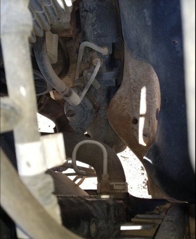

My pro charges $50. It is in a 96 f150. Looks real clean.
