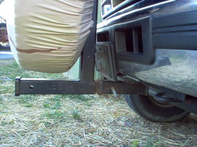

This mount has been on my Powerstroke for several years now. I have had no issues of any kind with it. The receiver hitch is a commercial unit. I built the mount out of pieces I had laying around.
It is as solid now as when I built it. No problems with engine temperature either.
I plan to make one for my IDI soon. I'll not use a hitch extension next time so as to have more flexibility in mounting height.
Oh yeah, the tire cover is a military surplus field pack cover. Works great.

you know i may build one for mine up front now easier access and if you have been ok with that mine will be fine i tend to use 1/4 inch and thicker stuff for almost all fabwork
