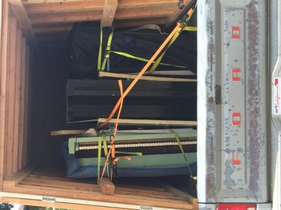

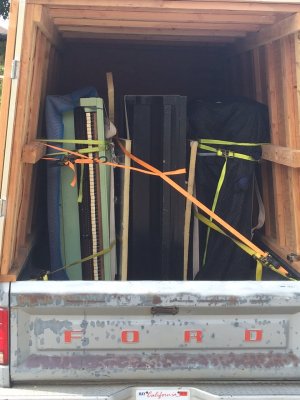

A little late... i moved a few projects to my Dad's place back in June. We're splitting the work on some spec jobs (piano restoration). Berkeley CA to Cincinnati OH.
IDIoit said he would help me out, gotta build a little more speed for the next trip. I'm new to IDIs, happy to report 7500 miles never stranded, nearly all of it cross country driving. Maybe I'm a dummy, but not much will stop one of these once you're rolling.....
Saw the PO for this truck while I was there, he said he finally met someone as crazy as he is....
