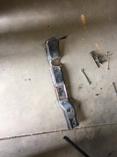

Truck had a C6 swapping to a ZF5, I took the uncut for D60 crossmember from a ZF5 truck and it looks identical as the cross member the C6 was using? Thought I read there’s a couple inch difference snd the slots for the mount are a bit different.

@IDIoit could you tell me how many inches of drop you welded into your crossmember to clear the d60 front shaft? If you don’t recall it’s cool I’ll mock it up and measure.
i lowered the trans mount down 2" to the bottom of the cross member and then just clearanced it and welded a piece of pipe to it
