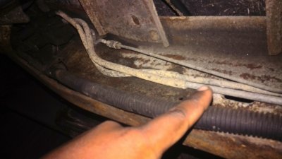

So right there where the rubber line is coming from the FSV going into the steel fuel line? How did u get the hose off the steel line? Mine is stuck on and they also need to be replaced. Also for the steel line, did u use a dremel to cut a section out?

Just cut it. I would use a dedicated tube cutter.
But recon a Dremel would would, just make it jagged though.
Why do you think that section needs replaced?
