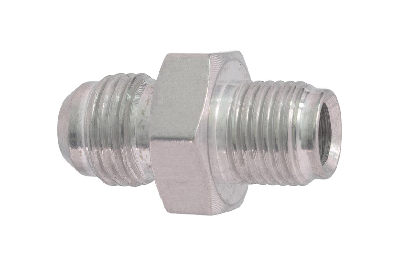

I had links for all steel an/jic fittings, but that site is down.
Ether of these fittings will work for the pump, the first would be one less fitting to deal with.

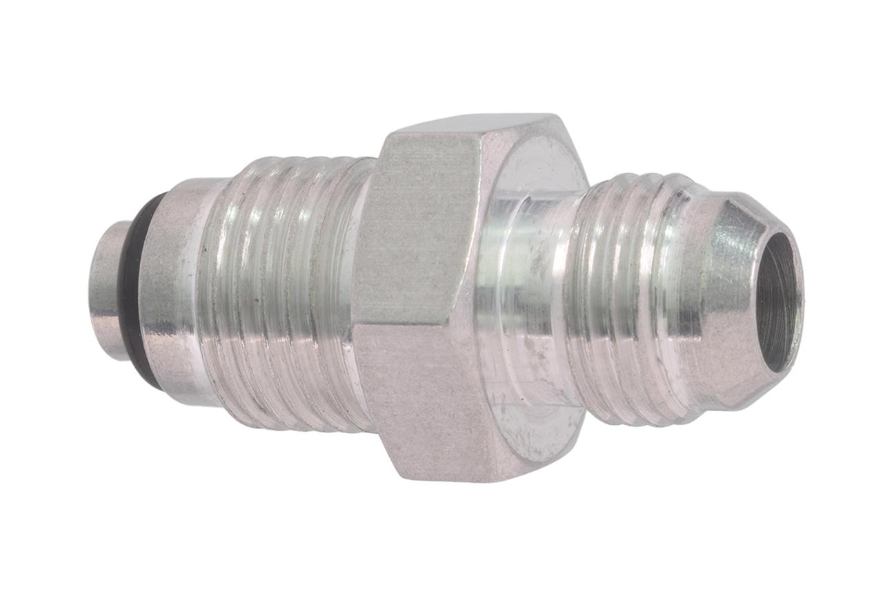

This is pressure in to the hydroboost

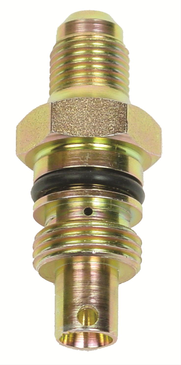

And this is pressure into the gear box
With these, all you need is to mesure for your hose. Then go to a hydrolic shop and ask for -06 hose, with -06 90* jic fittings. Dash sizes are in 16th of a inch, so -06 is 1/2in.
