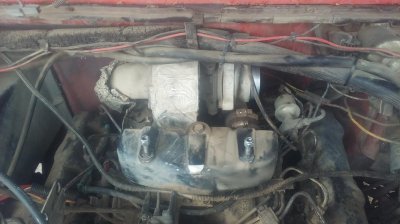

I began removing the airbox. The filter is so dusty. The other side has oil everywhere. Is this normal? Maybe coming from the CDR?
To the right of the turbo there is a vertical hose. It is covered/leaking oil. I think this is the same oil in the airbox.

More pictures for your enjoyment and possibly to help me.
Pic 1: what is this hanging off of the injection pump? It is on like a ground screw would be connected.
Pic 2: The injector line from the filter to the pump is wet at the pump. Should I try tightening it or does it have a washer or oring to replace?
Pic 3: Oil in the airbox

1. Tamper tag. Just let's the IP shop know if someone screwed with it.
2. It has a olive, iirc.
3. It's from the cdr. You can clean it off.
