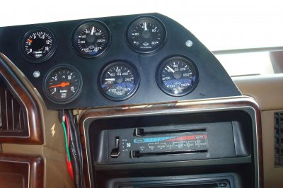

Also what are opinions on the boost gauges pictured above, Im leaning towards the Banks one, as it is more in the realm of IDI boost levels. The gauge is made by ISSpro as well
Ill post more pics as they come, The Elbow and down pipe are at the ceramic coating place now.
These are the isspro gauges I run. They are the EV type with the 270 degrees of sweep.

Nice Gauges!!!

I ran Isspro for turbo and pyro. You are correct in that the markings on the Banks is better suited for lower boost readability. I clocked my gauges so that the sweet spot reading was 12:00. Made glancing at them easier. As for the fire wall +1 on notching. I used a scissor jack between the bellhousing and firewall to push the firewall seam in. Worked good for me.
