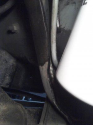

Thanks everyone. The Wix 51734XE (10 micron) filter is installed.;Sweet Wish I'd done this a long time ago. Picture is below.
Similar to pybyr, I had fuel line interference. To bend the tubing, I used a brake-spoon wedged under the tubing, a c-clamp above the spoon, then press the lower part towards the cross-member. Rubber gasket material was used to protect the tubing. After a little tweaking it's lays nicely out of the way.
The XE filter is flatter (and longer) on the bottom compared to the regular 51734, and the clearance was a little tight for my preference -- about 3/8 inch. It probably would have been fine, but decided to grind the cross-member slightly to get about 1/2 inch of clearance. You can see that just below dead center of the attached picture. The brake line, and the re-positioned fuel line, are visible just above the relieved area.
At 10 micron, this filter is 3 times finer then the stock IDI filter, and 2 times finer then the standard PSD filter. Anyone have any experience with it?

Mounts are good, I believe it's just the tolerances involved in the assembly. If you get a chance, would you slide something in between the filter and cross-member and see what the gap is on yours?
