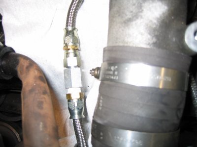

I went to the local hydraulics shop today and took the new line with me. I explained to the guy how I wanted to splice the one good end onto the old hose that was still in the truck. He took the line in the back and a few minutes later returned with the line cut in two, and the "good" end had a compression fitting, an adapter, and another compression fitting on it. It was exactly what I was looking for. He told me it would have no problems holding 200 psi of oil. Problem solved! ;Sweet

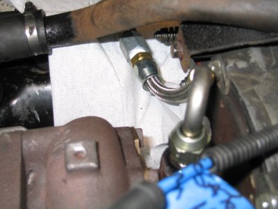

Well, the splice from the hydraulic shop is holding, at least for now :hail.
Here are pictures of the splice and the infeed to the turbo. It's the other end I could not get to.
