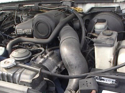

338
The hose and molded part is the same as the hose that goes to the intake bowl.
