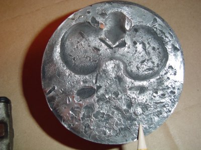

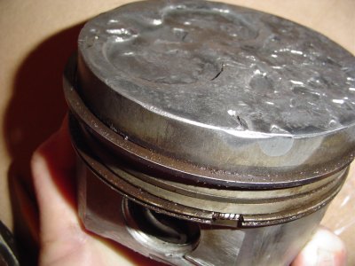

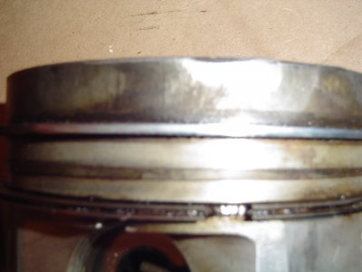

What type new glow plugs did you install. After many years of trying all different brands. It has been determined that ONLY the Motorcraft ZD9 Beru will last. Champion and Autolite are a horrible plug and should never be used. They tend to burn out fast. Swell so they wont come out requiring the heads to come orr or swell and break off damaging the turbo if you have one or ruining the top of the pistons. Here is a pic of an engine I purchased where the fool ran the engine with a glow plug broken off in the cylinder.
