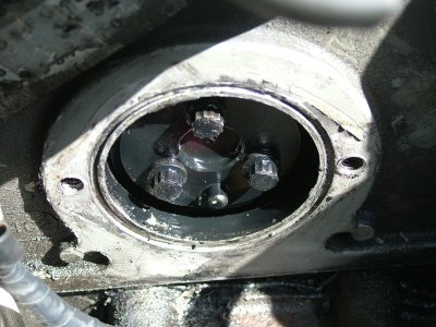

As mentioned above, DO NOT remove the gear tower. Remove the IP from the gear tower. Doing things this way you will retain the timing as it was. You will still need to time the engine, but this way you will be relatively close. To remove the IP from the gear tower you must remove the plate from the front of the tower, exposing three bolts. A normal 12 point socket will loosen those bolts. Another three on the backside of the tower hold the IP from rotating--ie timing adjustment. One of the lower of those three is usually a read SOB.
Anyway, a picture of the three hidden bolts on the front side of the gear tower.
