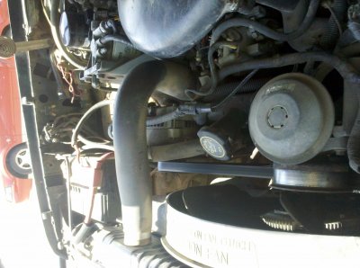

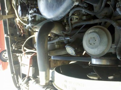

Well I drove to Canyon/Amarillo today (about 90mi) and smelled oil..... found a small leak when I arrived. Going to have to track that down after I get home sunday.
When I pooped the hood I also saw this :eek::eek::eek: pressurized/bloated radiator hose
Im hoping it is just a bad radiator cap or maybe the oil cooler...hopefully not head-gaskets
I do not see any bubbling when I pull the rad cap so I still a tiny iota of hope
Im going to check when i start it up and see if it bloats instantly...that will help determine if its HG related

Oh nooooooo!
Well good news (maybe) is that the pressure did not immediately spike when I started the truck...Im still worried about HGs though. It's in the back fo my mind. After a few mins at idle the hose was still soft.
Im going to have oreillies test my rad cap. Ill probably go ahead and replace the cap and replace the rad hoses. Im also going to do a cooling system flush probably tuesday. At least that way I can cross another cause of the list.
What else would y'all recommend? compression test on the motor?

I dont thonk i would do a flush with the possibility of the flush fluid getting in my oil or any other unwanted area, but especially not my oil.

Hmmm I didnt think of that. I was going off of the idea that it might flush out of radiator/oil cooler if they were clogged/plugged.
Ill follow the advice o justin and test my coolant for cylinder gasses then go from there.
test the coolant for cylinder gasses.
Good idea, I have been reading about doing that. From what I have to understand is I have to buy the tester and the fluid. Ill be of to napa as soon as I get home...maybe tomorow if I get the time.
Im off to the search function and read up some more.
Thanks for the help y'all

It is always good to know the compression of your engine. It will give you extra confidence in troubleshooting and a good baseline for future problems.

I wont be able to have a shop test my cylinder compression right now as I am not comfortable in driving the truck in the current condition. On the way home, I stopped to check my oil level (because of the leak) and it was still full and I think Im getting coolant in oil and vice versa as my coolant level is still normal but shows little bits of something floating in it (Im thinking oil) but not sure yet.
the strange part is my oil wasnt the normal "choc shake" but was very thin when I checked it on the way home and when I arrived home.
Im going to check for exhaust gasses next week when the tester arrives then go from there....either headgaskets and/or oil cooler but hopefully not both at the same time. Once I get that done and the truck is driveable I can have a shop check compression and start w/the other things I need to fix....that's the plan at least.
