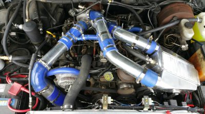

I run a water intercooler on my truck, you can make a good kit for under $600 with 1/10 the piping and I still have my ac in place. I have a bull moose and misters, truck is 9klb and I only run 7psi with no get issues. Here's a video of a 5th gear pull from 45 to 75mph

Shawn MacAnanny
Feb 12, 2016
818
44
Delaware
It doesn't take up much room and there is zero lag from the short piping
That's the intercooler that I went with for my 85 rebuild.
