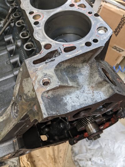

Mine is seeping in the same spots in both heads. I pulled all the accessories and checked/redid the thermostat gasket. Of course, mine hasn't ever had the head gaskets done. I've traced the leak location to the rectangular shaped coolant passage. Doesn't help much in your situation though.
Did you use a bottom tap before doing the bolts/ studs? It could have gunk in it and not clamping properly on the front of the head.
The pic is the opposite side of the block, but mine is seeping from the same on both sides. I'd check the two bolts/studs especially around the passage.
Did you check the heads for warpage?
