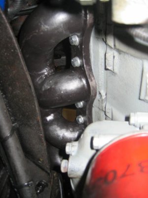

no one makes a "log style" manifold for the 6.9/7.3 do they? or even the flange that bolts to the head to make a headder off of do they? we're tossing ideas around and those are going to be the best route. i heard of a 550 IH tractor having twin turbo manifolds but i highly doubt that will have the same manifold pattern... :dunno

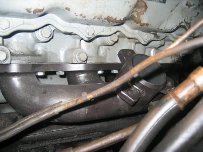

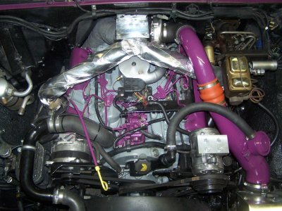

You want something similar to this?

wow that's the best upgrade u could ever do to a chebby! LOL yea like that, only i want them to dump up in the front on both sides as that's where i have the most room under the hood of the scout! where'd u get those manifolds made?
