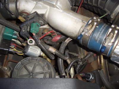

Well the ICP, and CPS have been replaced and the FPR has been rebuilt with the high pressure spring but it still seems to have a problem. Friday I was driving ~65mph on flat ground, no load, ~70F out and it died for a second when turning left. I was waiting in the left turn lane and it took off and then died and then took off again. Sure glad it did not leave me there in the middle of the road.
This morning I looked the engine over and checked connectors to make sure they were on tight and looked over the wires for mouse damage. I did not see anything except this unconnected ground. I assume I forgot to reconnect when I changed the UVCHs. Where does it go? The one end is connected to the upper front bolt of the DS intake manifold and it is ~14" long 10 gauge with a 5/16" ring terminal on the unconnected end.

With your mileage whens the last time,if ever,were the injector orings replaced?a 99-03 psd should not be throwing low icp codes unless youre running HUGE injectors or seriously hot programs.
