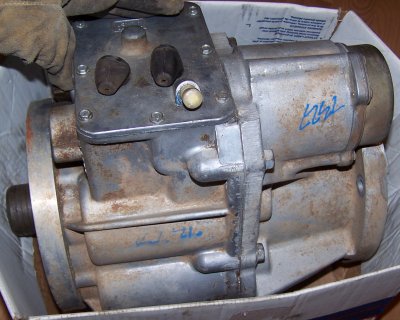

Let me start this thread by thanking towcat for catching this ad on CL that I would almost certainly have missed otherwise. I also need to thank my dispatchers at work, who somehow forgot to include me on the schedule for today, giving me a rare Saturday off and making it possible for me to run up to Vacaville to snag this before anyone else was able to. ;Sweet maybe my uncle's up there keeping an eye on me :angel:

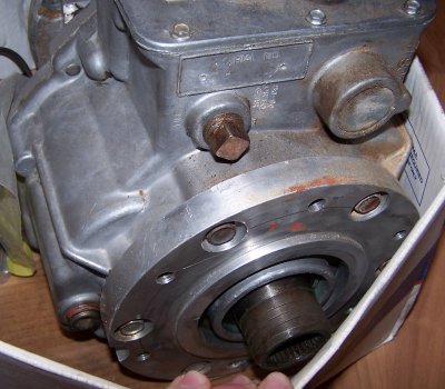

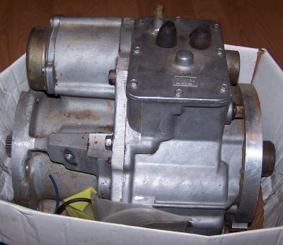

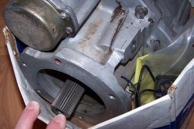

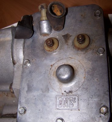

For the reasonable sum of $650, I'm now the proud owner of a Doug Nash overdrive unit. The guy I bought it from said that, when he looked at it, he saw a tag saying it had been rebuilt...he wasn't sure when, but given how clean it is, I'm guessing it wasn't too long ago. I didn't have a ready source of 12 volts available at the time, so I haven't been able to test it, but it spins smoothly and he said that it shifted just fine. Hopefully all will be well!
I've been wanting to either add an OD unit or swap to 3.54's for many years...quite simply, I spend so much time cruising on the freeway that, even with the ZF, my RPM's are higher than I'd like. IMHO this gives me the best of both worlds...with the 4.10's and the F-450 tranny's lower 1st gear, I can get any load started that I want, and if my calculations are correct, I should be able to cruise at 70 mph at 1889 RPM...which is my RPM at 55 mph without the OD unit.
I'm excited and had to share :angel: ...

It's basically a U.S. Gear unit (IIRC U.S. Gear bought out Doug Nash at some point and kept building the boxes basically unchanged), so parts should still be available if needed. I need to get an Eaton switch for it :sly What I've always heard is that it doesn't shift quite as fluidly as a GearVendors, but it's a more stout unit...while you can use either unit on a manual or an auto, I've concluded that the Doug Nash/U.S. Gear unit's more manual-transmission friendly and the GearVendors is more automatic-friendly...
I'm a happy camper at the moment, although I'll be happier when it's installed...although that gets to wait until I take my truck out of service. I've been wanting one of these for years... ;Sweet

I think that the OD units for 2 wheel drives replace the tranny's tailshaft, making it more difficult to install. For a 4x4 application, it's actually really simple...just unbolt the transfer case, bolt the OD unit in place of the transfer case, and then bolt the transfer case to the back of the OD unit. With that said, yes, I'll need to lengthen the front driveshaft and shorten the rear driveshaft.
I'm pretty sure it's not possible to mount a Doug Nash/U.S. Gear OD unit that's meant for a 2 wheel drive, behind the transfer case. However, the GearVendors unit is meant to go behind the transfer case on a 4x4...IIRC some GV units include a new case half for the back side of the transfer case, with provisions to mount the unit to, and other units are meant to replace the carrier bearing. I'm not sure, though...I'm not as well-versed on the GV units. Mel would know ;Sweet
