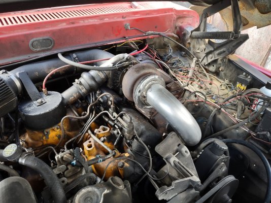

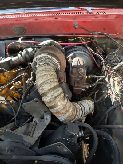

I've been running one for years, off a 6.9. and on my 1989 7.3 idi. Just doing some exhaust work. Works great. But different
OlKoot
Jul 17, 2007
117
50
Creston Canada
I get up to 10 inches of boost. Helps with mileage 15% plus. And the hills. Sounds cool too
