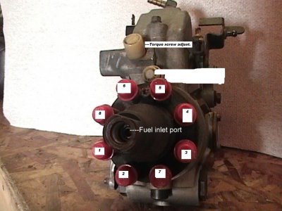

Diesel fuel in itself does not gum up, but is susceptable to absorbing water over a long period. The way I would store the IP and injectors would be to plug all the opens on them with what diesel fuel is left in them, then put them in a Zip Lock bag, close them up to the point where you can put a small cocktail straw in them, suck all the air out you can, then close it up quickly. If you have a rebuild shop close, they would have the caps and plugs if you didn't save any. Pic below shows the caps on an IP. Don't have a pic of the injectors, but when you got the, they should have been sealed.
