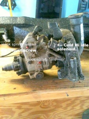

If you have a magnet on a flexiable line fish around under the pump and intake manifold all the way to the back. It may have been screwed out too far and was dropped. You need a spring incorperated with this screw for it to stay set. Any good injection pump repair shop will have this screw and spring.. Or most walkin wrecking yards surely will have this. Even the chevy 6.2 and 6.5 engines used this pump but with a slight differece.
338
10-24 x 1" long. Hardware stores also have springs.

Thanks everyone! I found a screw in the shop yesterday that worked but I may get the right size with the spring now that I know the size. I put a dab of superglue to hold the screw in place as a temporary solution.
