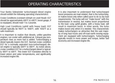

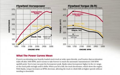

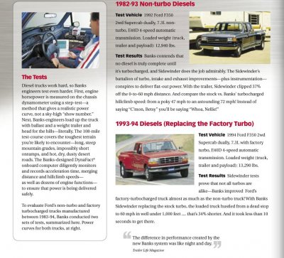

attachment.php
attachment.php
attachment.php
374
Great conversations going, and please.... I'm not the only guru here by far! Listen to these other guys as well. A little disagreement helps point out issues that might not otherwise be discussed, as long as its all kept civil. That Banks literature is interesting. What isn't clear, and what they don't tell you is.... did they touch the IP at all when they swapped their turbo on? That's my suspicion. A turbo is good for 50 HP over NA, and the factory turbo offered only 10hp more than NA. This was due more to the calibration of the injection pump then the application of the turbo itself. If Banks swapped their turbo over, there would have been no HP change without turning up the fuel!
