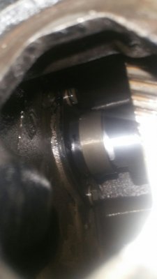

You guys are right you cant get a bore scope in the oil fil or in the tach sensor. I removed the mechnical fuel pump to block off and snapped a pic, i meant to pull plate off and see if i could get a bore scope in there to see marks. What do you guys think?
