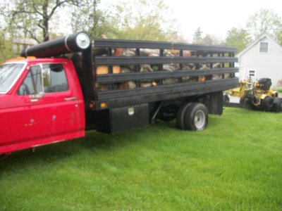

FORDF250HDXLT
Dec 27, 2009
6,456
1,127
Maine & Oklahoma
log trucks first (and still so far lol) day out.i know it doesn't help much,i just like to show it.:D can't wait to use it again.
