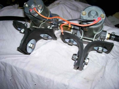

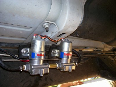

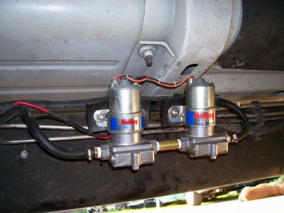

I know the FASS is awesome, if you have the bucks to shellout. Here's what I did. You ask, "why two in series?" Well, diesel is a little thicker than gas and the smaller (Blue) pumps tend to overload and burnup after a few months, some sooner, but these are the 149 gph black pumps and if you run them in series, the load on each pump is lower and thus they tend to last as long as a pump twice their size and capacity.
I still have my stock LP and now my fuel press is nothing less than 10.5-12 at full throttle with my electronics set on the 6 spot. (Banks 6-Gun w/speedloader) and a 12,000# trailer dragging along behind.
