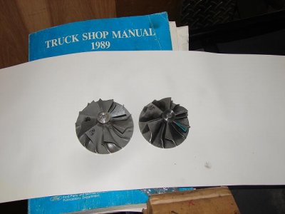

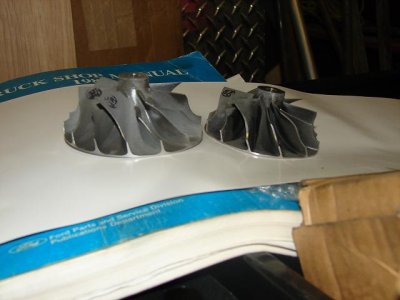

typ4
Dec 24, 2005
9,117
1,399
Newberg,OR
my turbine is a stock ats, the compressor is a super 60 wheel, just a bit bigger.
