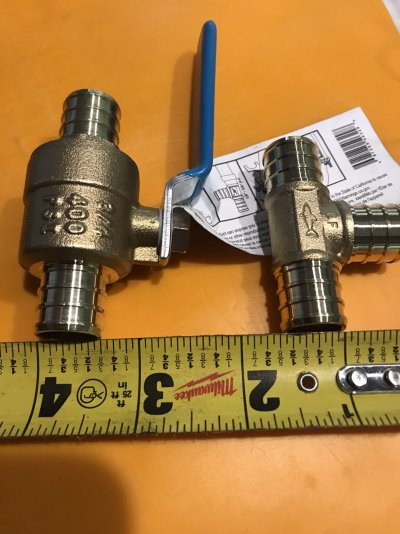

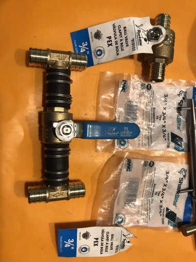

Another upgrade complete, finished the install of NAPA coolant filter head and a heater core bypass. I have seen where several have done the bypass with elbows, nipples and tees, FYI: sharkbite 3/4” fitting fit 5/8” heater hose perfectly and looks much cleaner. Also did a custom fabed bracket for the filter head.

Thats a clean set-up. Really like the mounting bracket. My coolant filter has just been hanging out on the fender , this gives me motivation to actually mount it and do the heater core by-pass. Thanks!
