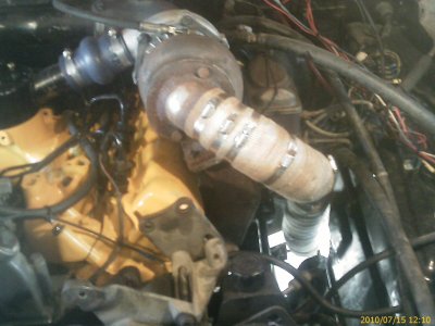

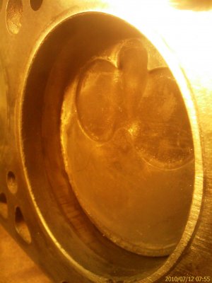

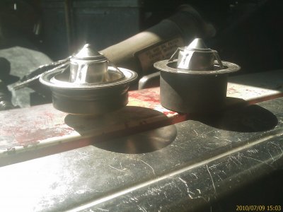

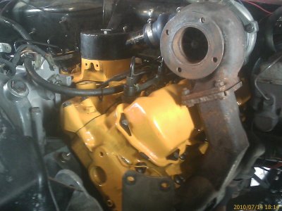

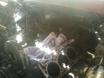

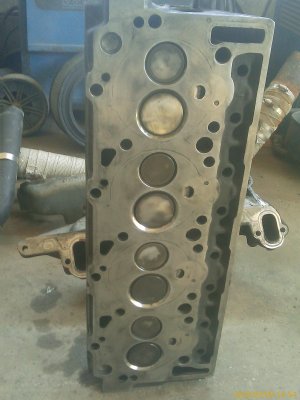

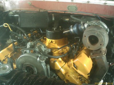

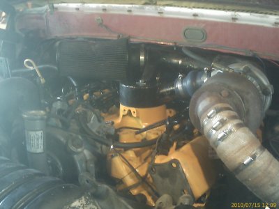

Almost done, Head Gaskets, Thermostat, antique turbo installation. and some nice caterpillar yellow paint. Cool ;Sweet

I kind of like this turbo setup. I wonder how it performs? Could do duals this way. Then you would not need an exhaust crossover.
Clydesdale
Nov 8, 2008
1,155
Nampa,Id
we thought about that for mine, duals , true duals, not compound, say t-3's off a Volv 240/740 gasser...oil and watercooled... set from Factory at 8 psi, easily moddable to 15ish, and seemingly the boost doesn't double that way, but the flow/volume does, which would be Ideal... Y pipe them into the IC, and then I pipe into the manifold.
grab a couple of different manifolds, I think we wanted two pass, backwards, so the shot straight up, or was it two drver.. pass would have created the need for an Elbow, and driver would shoot straight up.. Never went pass drinking a beer and looking at any one of the 3 6.9's on the shop floor.

Looks neat ;Sweet
But, why did you choose to run the turbo that way? Not down talking you or anything just wondering. I would think flipping it 180* where it mounts so the exhaust is at the back, would be easier for a downpipe.
What kind of turbo?

Air filter located in the rear might pick up too much heat.
Might want to try to route it to the front.
By the way, like that cat yellow.;Sweet

Maybe something to do with the direction of the Turbine. And the affordability of available turbo's to use. Either way there is enough room to funnel the 3 inch pipe out the drivers side inner fender and out the back under the body.

Side mounted turbo
Thanks for the comments, here's a couple more pics:thumbsup:

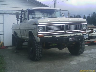

This is the truck, 1970 F-250, dana 60 front end from a 78 supercab, NP 205, 4spd, air bags, siginaw steering, Por-15 undercoat, A/C (still installing), JVC with usb and bluetooth, PTO winch, New brakes last month, LMC supplied the weather stripping and widow seals...twin 1025 cca Napa batteries. 37x12.5x16.5 Goodyear Wranglers from 100dollarman.com
wants- ranger gear splitter overdrive, new paint back to original candy apple and white two tone. ;Sweet:thumbsup:

Beautiful truck, and a great example of originalality on an envy enspiring project.
