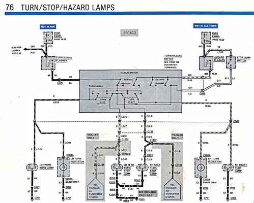

The original setup had a very complex switch in the steering column. This switch did the hazard functions and the turn/brake functions all in one. Here is a diagram of a 1986. While it' earlier than your 89 and some of the wire colors may be different, the theme is the same.

Get a box of fuses. Put it in without starting the truck. The lights work ok forever and ever? If so, the problem is not the hazard lights but something else on that fuse. Problem is, you do not have a diagram I think you said. If you did, you could figure out what else is on that fuse.
Not sure if you could leave the fuse out, turn the truck on, and figure out what else is not working. You can see in the factory diagram above, in 1986 they had the brake lights on the same fuse as the hazards.
We just went round and round with another guy on here who was blowing fuses and thought it was some thing in the turnsignal circuit. Come to find out, it was something to do with the reverse lights, which are on the same fuse as the turn lights.
