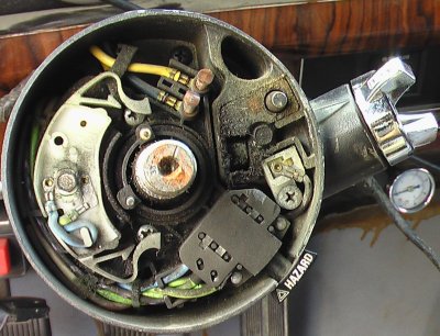

I've got my tilt column all apart right now. If you need pics let me know. My starter switch was sticking in the on position.
My rig is an '84.

Here's the one minus the steering wheel. Again this is on an '84 tilt wheel. It's a little dirty. I'm surprised I wasn't having problems earlier.
