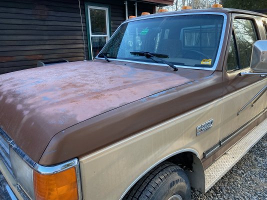

The only part that looks bad now is the hood. So I'm going to do a temporary something.
Even with proper equipment and paint I don't have any experience with it so I will likely do more harm than good.
I am not inclined to do anything more than a half-azzed job (as the title states) on the hood until I have the money to pay someone for a proper whole-truck job (even though the rest of the truck looks fine). I'm not going to put more than a few hours into it. The thread has gotten away from that so I guess I'll just wing it.
A high build enamel will lay flat on its own and not need a perfect suffice to look good. You could look for a local paint shop and see if they can mix you some in a spray can, you can get a refill spray can and get a small bit from them if they dont. Just make sure the surfice is all scuffed up so the paint will stick, then wipe down with mek or acetone. This paint wont want to stay mixed, so spray a line, shake the can, then repeat. With the primer, spary some on card board at the same time as you spray the hood. When the paint on the card board is dry to touch, shoot your top coat and your done. Since you will be doing it out a spray can, you wont have hardner. It needs some days to set and do it where the sun will shine on it for heat, and do it when not cool out. This will give you the best chance for it to set.
If it is the original paint and there is not a clear coat that is pealing, just fading color, you could try polishing the paint to remove the oxidation. That would require a cheap electric buffer, some pads, and polishing compounds. Some paints will polish up great and some won't. As a test, use a soft cotton rag with some toothpaste and give a small area a good rubbing. If you like the results, use a buffer, but only on low speed and with light pressure. There are youtube videos that will show you how.

I'm sure the rest of the truck would buff out to be very nice. It looks pretty nice now.
The hood is toast. It's an eyesore. Even a 15 minute job with a can from the dollar store would have to look better.
