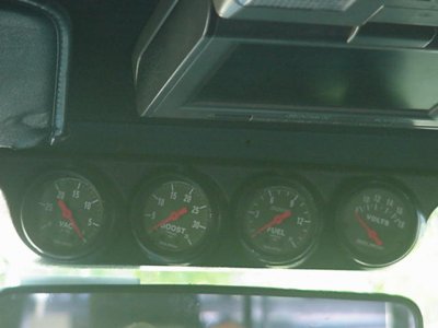

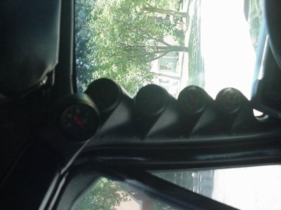

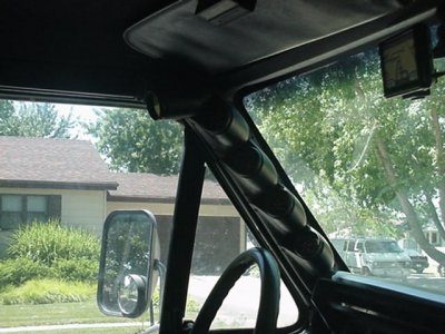

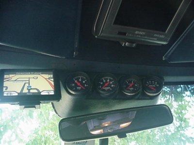

so a two pod on the a pillar and two custom mounts above the mirror along the plastic piece at the top of the windshield.
nope 5 singles on the pillar, cut and molded together. and a stuperduty 4 gauge pod cut and trimmed over the rear view

ask and you shall receive

now you need a turbo to move that boost gage!
i like the center gages, how hard was that to finagle in?

hated to do it, but i drilled two holes and installed screws with washers, to catch the front lip. then i had to cut an opening in the metal headliner trim for all the wires to pass by. then i had to trim the gauge pod itself to conform to the contours of the truck. after all that i installed window tint behind it and trimmed it to the pod. worked great with the velcro on the backside of the pod till it got hot then the sticky started to un-stick in the heat. so i had to super glue the velcro to the pod and the window tint. hasn't moved since. my application is for an 80-86 body style. i'm not filmilar with how the newer trucks
are put together
