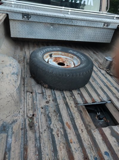

This is in the bed of my truck, I've always assumed it was for a spare tire.
