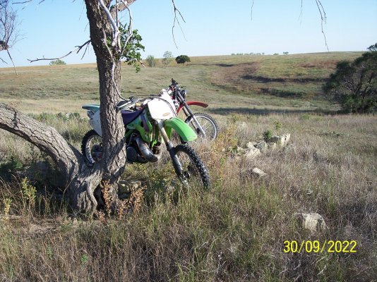

12,323
11,046

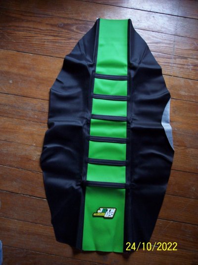

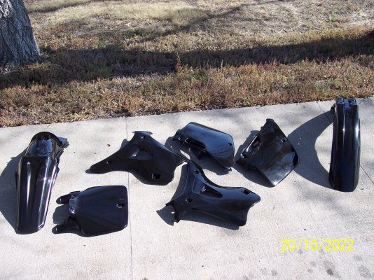

Yep. It's a 97 KX250 that I've had since April or May of 2005. It still has the same tires that I bought it with. It's about time to do a little bit of updating though. Here's a little hint. I say that I want it to look like a two wheeled Monster Energy can.
