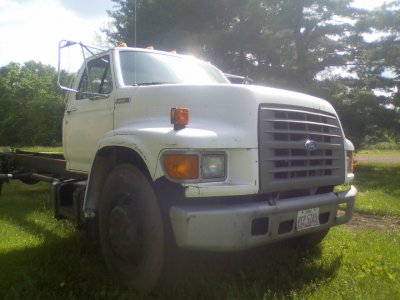

Good looking truck! I am going to be starting a crew cab conversion to mine. As stated the firewall and rear cab mounts are different than a pickup. Mine is a couple years newer and has the more rounded front hood. I wish I had air brakes though, it has the hydro unit now but I might swap out for something different IF I can locate the parts I want. Do you know what the weight is without a bed? Mine is 8820# right now but I have about 12 feet of frame to remove.

Thanks guys :D ... Great truck Ironman03R ;Sweet ... If it was for me i would be driving these trucks as a daily driver, but why those parking lots are so small here :dunno , i can't even drive my F250 daily, because of the same reason :backoff ....
I actually don't know the weight, i should have it scaled to see what it is. People who shipped the truck from US put a weight of 7700 pounds on the papers, but i really doubt it's the real number, since back then it had a bed on it and even that alone weights a lot. Plus they inform the weight wrong all the time, probably they get the freight down that way :dunno . Those air brakes seems to be very powerful, i don't know if i had bought it at all if it had the hydraulic unit. BUT the reason for it is because i live a bit far from parts if it needed one. I've read that parts are difficult to find for that hydro system and imagine if you live 5000 miles from their original source and that's airways :eek: . There's a lot of air brake semi trucks here, so if i have some brake line or component issue i might be able to locate one from here. I bet the brake system is similar to Ford Cargo, which was sold here back then. I've noticed that it is a lot harder to find parts for these even compared to my F250, which is quite easy for most parts because of Rockauto, LMC etc. which really doesn't know F700 apart from few parts...
