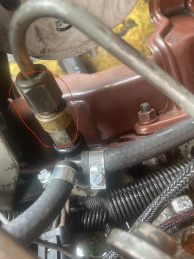

I know this has been discussed before but at least from the posts I saw the only options were finding one of the lines off a van or classic diesel designs used to sell them but does not anymore.
Got a baby moose fuel injection pump, installed, runs great but was leaking out of/around injector 1. Took off clamps and attempted to remove hard line to adapter/extension when the nut cracked nearly in half as I loosened it. Very weird, think it was cross threaded. Am supposed to be moving tomorrow so I got a new line and tried to see if I could screw it back on even if the threads were kind of damamged and no luck. Looks like I’ll need a new extender for sure. I was hoping someone had a slick idea of how to put your own together or any other advice.
I have called all the salvage yards in my area, checked Facebook mp, Craigslist, etc. Waiting on a reply from two people but not hopeful about it. Really any help would be appreciated don’t want to end up stranded in Texas.
Thanks y’all.

I think it is only on the 7.3 engines, has something to do with timing them as I remember.
Can you find the hard line to that injector for a 6.9? There has to be IDI guys in your area, I wold hope.
I just did a search through my spare IP`s and Hard Lines I dragged home from PNP. But I do have one on my spare 7.3.
Really not sure of the reason for it and just on the 7.3`s.
Do a seach on PNP`s in your area to see what they have. Or www.row52.com and type in F250/350 etc to see what comes up. Do a wide search area, all PNP type yards connected to it will come up. Maybe some IDI`s will be in the heard.

Yes IIRC it's for timing the engine. I stripped one out once so I slightly bent #1 injector line & very carefully got it to thread up to #1 injector.
Don't think it's really important. However by having it then the clamps on injector lines clamp up better.
If you can find #1 injector line from a van then it fits cause the "Thingie extender" is on #4 injector on a van.

I've got a one left, the other two are spoken for (*** sent on those) if anyone needs one. Have a bunch of linesets as well

That timing thingy I think might have been where the Ford dealers clamped the Factory Timing clamp for the Rotunda Meters.

Found some in a salvage yard and picked up an extra in case. Found it off of row52.com
Thank y’all again for the help. Hopefully will be back on the road by this evening.
