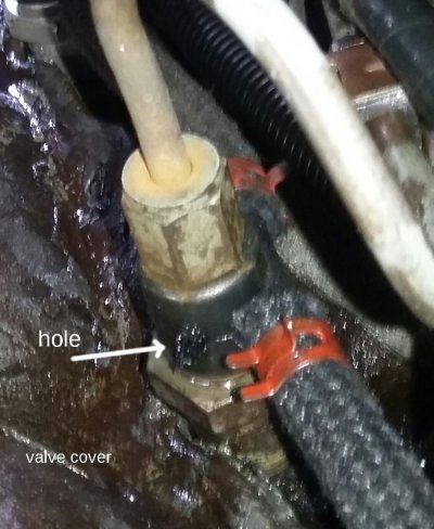

UPDATE
Last night was the first time I was able to look into things.
There was a puddle of diesel on the floor by the gas pedal.
There was fuel along the valve cover flange..
What I thought was a leaking injector cap on #8 turned out to be an actual HOLE in the injector cap, that was spraying fuel.
Diesel was hitting the inside of the dog house, and it seeped on to the floor.
When I started the engine without the doghouse on, I could watch the fuel spurting out the hole while it idled. (shooting far enough to reach my pants)
(Could back-pressure from a blocked return line rupture an injector cap???)
The picture is a little out of focus, but you can see the hole along the seam on the midline of the cap.

ISPKI
Jul 13, 2015
1,082
661
Granby CT
possible stuck injector
If the injector was stuck, wouldnt the pressure just push it's way down the return lines and out to the fuel tank? There shouldnt be a way for pressure to build up like that at the cap to the levels needed to block a hole thru the injector return cap...right?
At least injector caps are easy fixes and that explains your smoking and performance issues. I drop my truck about 12 miles with one injector cap loose and it was a miserable experience. You dont really realize how much fuel flows through those tiny fuel lines until its billowing out of your truck like a steam engine.
gnathv
Oct 18, 2007
1,051
528
Athens, Al
If your injector hangs open on compression stroke (heat) is pushing up to the caps and ip lines.
TNBrett
Oct 24, 2020
748
665
Middle Tennessee
You said you just changed the injectors. Who are they from? My first inclination would be to mark that one, pull all 8 and pop test them.
Fredrickson
Jan 17, 2020
181
153
Newburgh, NY
The set is from one of the providers often recommended on here..
I will change out the cap and o-rings, and see what happens,
as well as take a look at the ruptured cap.
