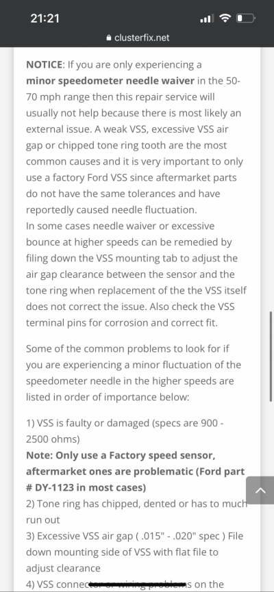

Found this information while looking for a PSOM rebuild. This is exactly what’s going on with my Speedo. 50-70 mph and it’s just a slight wiggle.
So I guess in need to pop off the differential cover and inspect some things?

You might get lucky and just pop the sensor back off and rotate the assembly, without removing the cover.
I think the rear is due for a fluid change so I’ll just get messy this next weekend I’m off. I have a sneaking suspicion that the tone ring might have damaged teeth.
