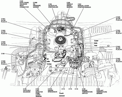

where is this located?
laserjock
Almost there...
Nov 20, 2012
8,841
3,130
This is it on the side of the ip gear housing.
