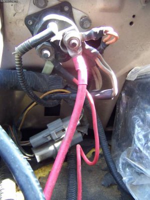

I re-read your post where you say you have a Volt meter instead of the charge lamp. But that Green wire might be a Red wire from the ignition switch. From 88 to 89 they went from the volt meter to the charge Lamp. You'll have to wire the Alternator like the 3G pic shows. There should be NO wire going to the starter relay/solenoid on the pass side fender from the Alternator, except a large Red (Battery) wire from the Alternator or battery to one side of the large terminal, see pic. There has to be a wire from the ignition switch in the start position to the relay/selenoid small terminal on it's side, evidently you have that because you can start. The 1st pic will show it with a volt meter and the way it has to be wired, it's shows with a fuse, but you probably won't have one. The 2nd pic is the start relay/solenoid where the large Red wire has to be connected. Your relay might not be exactly like this, the smaller Red wire shown goes to the starter.
338
The Alt is grounded thru the mounting, but it's best to have a separate grounding wire. On an 88, you might want to check and clean the ground wire from the battery to the engine, that's the main ground, there are others all over the place, there should be a short small ground wire from battery to chassis, they get rusted/corroded. It should charge if you have it wired like the 1st pic above.
