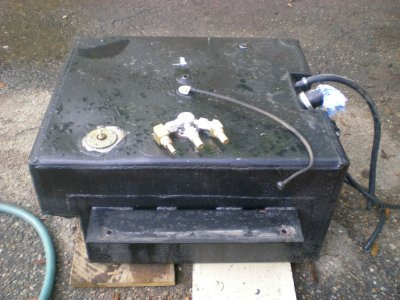

I'll take pics of it in the rear tank - unfortunately it's already installed in the tank, but you'll get the gist of it.

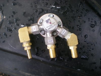

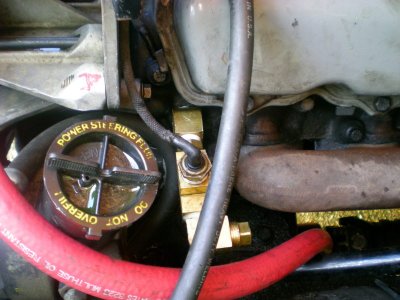

here ya go - one pic is of the brass contraption I built to house the temp sensor...
Debating on how to route the line to the pump housing. Was thinking of just coming up by the steering shaft on the manifold side (hope the hose doesn't melt)and up of the intake housing hose, over the IP to the pump, or around the PS filler neck under the compressor mount. Can't decide.

cool;Sweet , that is an aftermarket rear tank i assume. sure makes installing stuff easy on a flat surface.
