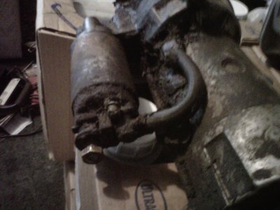

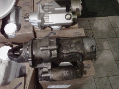

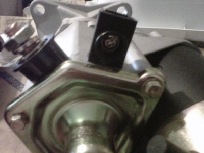

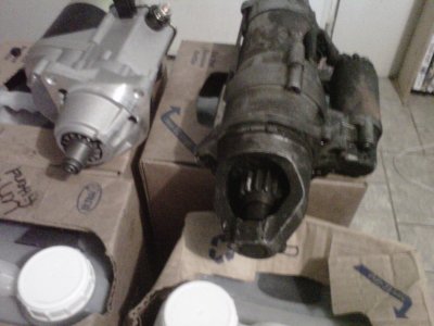

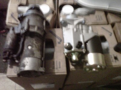

Okay we have a blizzard coming in and I was getting really tired of using a bottle torch to heat my starter up so it would work. Sounds crazy but that’s what it would take, seems to of had condensation or something turning into ice when its cold in the solenoid. Even when it would crank over it was really slow. I had a Mitsubishi starter and its a pretty heavy duty starter and long. Well I put the new nippo in that’s been laying here brand new for over a month and WOW! Don't hardly even need glow plugs now! I love the sound it makes when its cranking over it fires like a gas engine and fast.
I took some pictures here of the two side by side to compare. The nippo is a lot easier to fit in there without hitting the engine cross member but that top bolt was still a pain, mainly because my hands were frozen and I was laying under the truck on plywood in the snow. I didn't have to change any electrical connections at all. This starter seems like it won't put near the strain on the batteries as the old one.

I dunno I looked around on here for awhile for everyones opinion and a lot of people were telling me the nippodenso was the superior starter so I went for it. I haven't ever heard a diesel crank this fast I am really impressed. I love the sound it makes when its starting too it must be because its compressing so fast. If anyone wants my old starter its free, its outside in the snow in the scrap pile! I was going to keep it around for a spare but if this one goes out I will buy a new one again.
